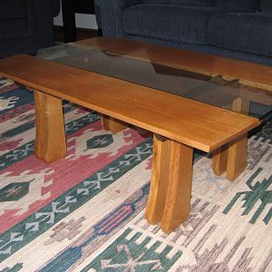

    Coffee Table in Padauk and Cherry
    Eight gracefully curved cherry legs support the french-polished padauk and glass top. Assembled with cross-laps, sliding dovetails and pegged bridle joints, this table stands with no metal fasteners or glue. Designed by Dale Raymond.

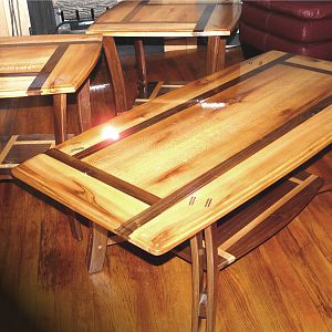

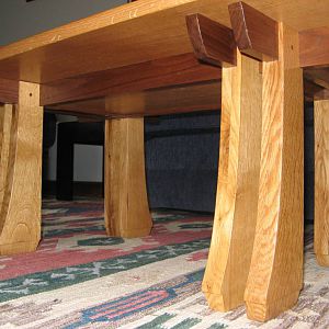

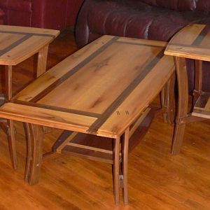

  2. QSS & Walnut coffee and end tables
    QSS & Walnut coffee table and end tables designed and built by John Skipper. The different types of joinery include tongue and groove, through tenons - double and singles, notches and square pegs. The tops of the tables and the legs are curved. Through tenons attach the legs to the...

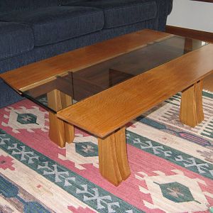

  3. Close_up_one_end_of_coffee_table_by stoneskipper
    QSS & Walnut coffee table John Skipper (stoneskipper). The different types of joinery include tongue and groove, through tenons - double and singles, notches and square pegs. The tops of the tables and the legs are curved. Through tenons attach the legs to the tops - double tenons on...

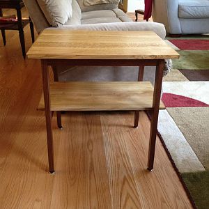

  4. Coffee_end_tables_2
    Coffee_end_tables_2

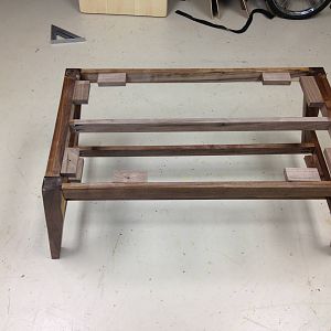

    Coffee Table redux - WIP pics
    I built a prototype for this table last fall - it turned out well enough to avoid the firewood pile but it took forever to finish it. I'm now making progress on this one, which is cherry and padauk. The joinery on this table is somewhat unusual and has been fun, but challenging. This is my third...

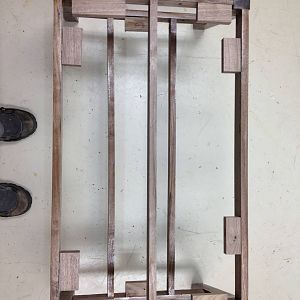

  9. Rocky Top Coffee Table - stretchers in place
    Here are all 6 stretchers in place

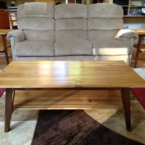

  15. buildintechie
    Finished Coffee Table...5 years in the making.

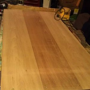

    I finally finished my coffee table today. I started building it over 5 years ago...and stole the concept from an Ikea coffee table. It took me so long, because once I built the panels and the tops I didn't want to continue because I was afraid I would mess it up. Well, the past 6 months I've...

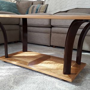

  16. merrill77

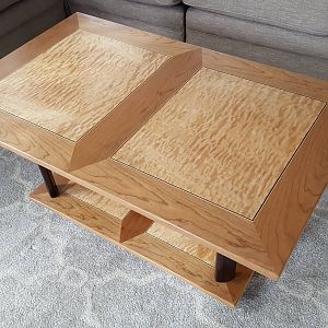

    Finished coffee table
    I finally finished my first version of this coffee table. These pictures aren't great - I need to take some time to get some better ones, but it might be a while since I get that done. The design of this table (not mine) uses an interesting combination of joinery that, if done right, should...

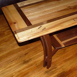

  20. bluedawg76
    walnut, maple. cherry coffee table
    Here's my new coffee table -walnut, wormy maple and cherry. There were several firsts on this table including the breadboard ends and the curved legs. The finish for the top is blo, followed by wipe-on poly. For the legs and apron I used garnet shellac and wipe-on poly. The shellac looked...
