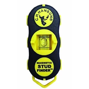

Use a magnet. It'll find the screws that hold the drywall, and by extension the studs. You'll probably want to find several screws to find out the middle of the stud.
I've used this little gizmo with great success:
