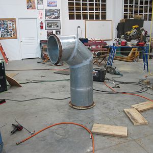

  7. The upper elbow is complete

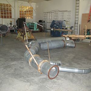

  9. Fabricating the second elbow
    I have finished cutting the pieces for the upper elbow, and am in the process of tack welding it together.

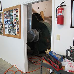

  10. Main riser viewed from the shop
  11. The main riser
    The main riser
    This photo provides a great reference to the scale of these components. Not the size of the ductwork and blower as compared with the door...

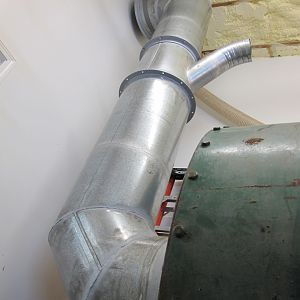

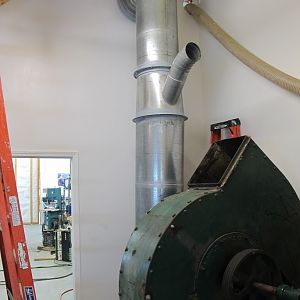

  12. The main riser installed
    Eureka! This afternoon Eric Wilberg and I installed the new main riser onto the blower.

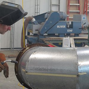

  14. Dust Collection - fabricating the first elbow
    NCWW member Doug Wilberg tacking the first elbow together.

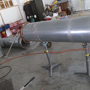

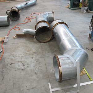

  15. Dust collection - fabricating the main riser
    The main riser components are laid out. Next step is to trim about 18" off of the bottom of one piece and weld it to the other.

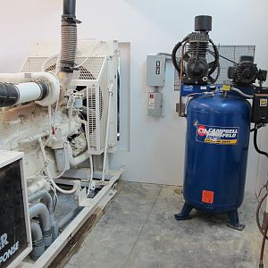

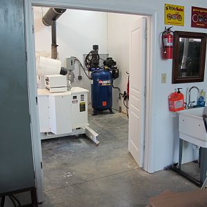

  16. Generator room
    Generator room
  17. Air compressor
    Air compressor

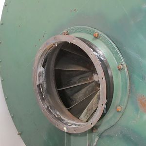

  18. Blower flange
    Blower flange
    This is a flange that I made and welded up to the blower inlet. Since the blower inlet is cast iron, the welding involved a lot of pre-heating, short beads, and then stress relieving.

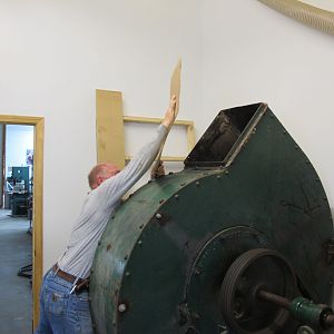

  19. Buffalo forge blower
    This is the closest that I could come to closing off the discharge on the blower while it was running!
