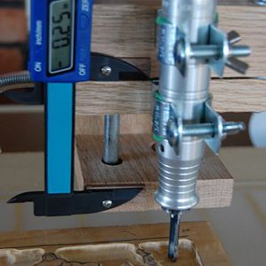

  18. PIC 46
    PIC 46
    Notice the change in depth gauge readout as I hogged out the background. Each pass I removed another 1/8-1/4"

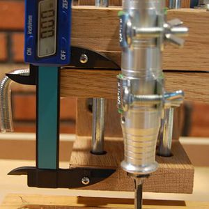

  20. PIC 44 - Hog out a carving
    The bit is set on the surface of the wood block and depth is set to zero
