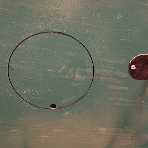

Revised Cyclone Bin Sensor Circuit
This is an improvement on my old Bin Sensor circuit. All 120V power through Remote Switch. 14/3 Romex from enclosure to Lamp/Photo-Eye. 12 V wall wart for Strobe Lamp not shown - connected to Remote Switch. Relay Bypass Switch allows continued DC operation after alarm when closed (useful when DC operation must continue to finish a process).
