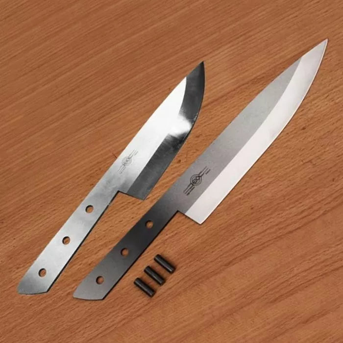

Im a realtor and make cutting boards for clients when they close on their home. These are very much appreciated. I also do gifts when someone refers me business but when I have a client that has sent me a few deals I run out of stuff to make them so I buy them something instead. I wanted to get into knife making. I dont want to do anything with the metal at all. Basically make a handle and attach it to the blank that is already sharp and ready to go. Does anyone have any recommendations for a company, website, or something else they can recommend. Im leaning towards doing chef knifes, maybe a santoku, and want moderately priced with decent performance. $50 or less for a blank would be ideal. Woodcraft carries Zhen which is chinese and the price point matches. I will look into those. just seeing if anyone can recommend something along those lines.
I havent made a knife handle before. What I would do i make a template and use that to trace onto the blanks. I like things I can repeat quickly to cut my time in the shop. Cutting boards are awesome for this. If anyone has made knife handles I would appreciate any input you have.

This is the address for Ron Hocks knife blade blanks. I have made lots of knife handles in the past. The key is finding a way to attach the handle to the knife blade.

I have bought a lot from Texas knife maker's supply and never been disappointed.
Knife blades, handle materials, specialty rivets and screws, grinding and polishing, pretty much everything you would need.

Mike that looks like a good source to explore. I don't buy stainless steel knife blades. I like high carbon and I just keep them out of the sink and water. Don't mean to sound too insistent but Ron's plane blades and knife blades have been just outstanding.

Still TKS is great for the rest of the supplies. And they have other blades as well as blade material to grind or tap-tap-tap your own.

Hock’s knife kit page has good method for fitting the handles.
I like the steel, too. But it is tool steel and will rust and discolor if you don’t keep it dry and out of the dishwasher.

Give Jantz a look, they sell a good product, but often sell out. I've gotten fillet and oyster knife blanks from them and have been satisfied with the quality, prices are reasonable too. You can email them if sold out and they fill orders pretty quick to repeat customers.

I've made six knives from Ron Hock's blades. The steel work is excellent, and Ron's got them really sharp. Instructions with them are straightforward such that any woodworker skill level can do it.
His plane blades work well, too, and are ready to use out of the box.

@Billm0066 I saw an advertisement for Damascus kitchen knives in the Woodcraft flyer and they were on sale, but there was a Stainless Steel Bread knife blank for $20.69.
I always ask Klingspor what they have first that is comparable.
If they don't have anything, for $21 and your labor for a bread knife, seems like a GREAT reasonably priced gift?! (What is it, salt, bread and a bread knife for a new homeowner? LOL)
