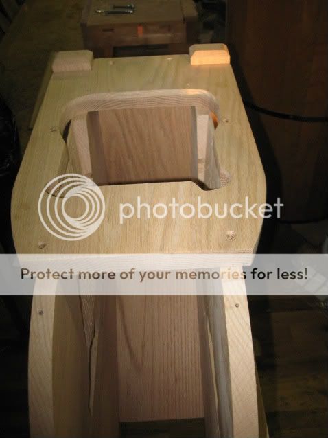

All of the joinery is mortice and tenon which I did with my handy-dandy bandsaw tenoning jig, forstner bits on the drill press and a little chisel work. I used the scroll saw to cut the holes out for the bearings and for the top in- feed section.
So after 3 days of woodworking and head scratching this is where I’m at with the restoration.I started by sizing all of the frame parts to 1 3/4×2 1/2 and planed all of the box pieces to 1” thick.
