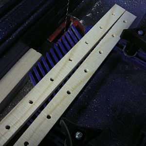

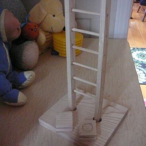

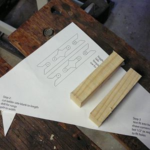

the corners of the ladder sides need to be shaved oh so slightly to fit in the base holes. I didn't bother gluing the ladder to the base and it has survives a weekend of thorough "testing"

field tester in action

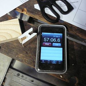

elapsed time to finished toggles

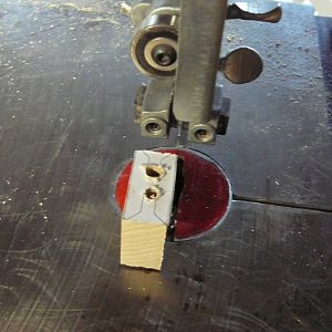

cut the slot and lead-in bevels

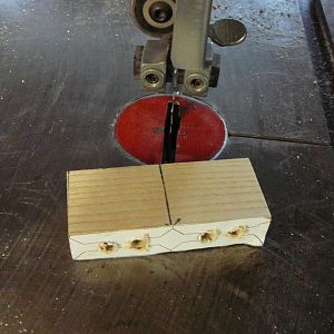

split the toggles

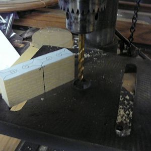

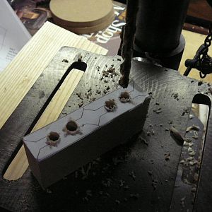

drill

check depth

switch to 1/4" bit

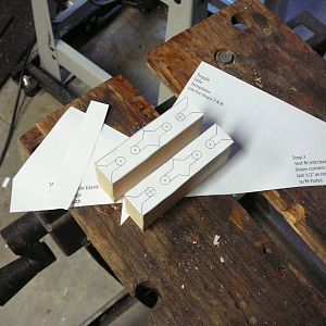

apply template to toggles

two sets of two toggles

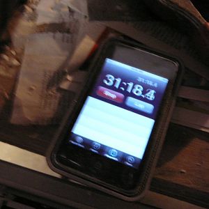

elapsed time to finished ladder

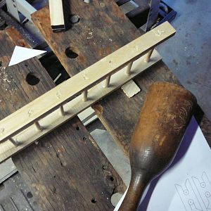

apply glue to other end of rung and assemble easiest to start at one end and work your way down little mallet came in handy

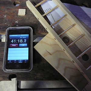

elapsed time to cut parts for ladder and base

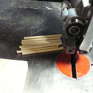

note- rung is past stock when cutting

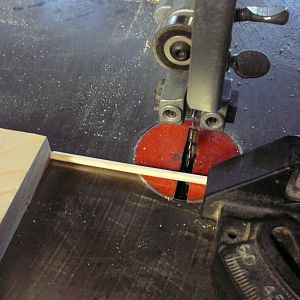

set up stop to cut rungs to length - 3"

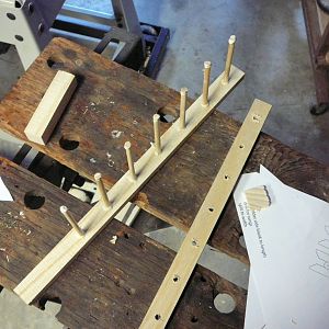

finished sides- used left over stock as push stick
