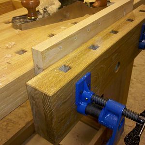

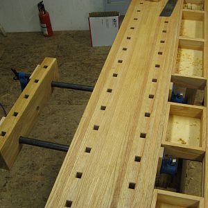

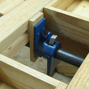

  15. Workbench build - face vice
    This block on the face of the rear pipe clamp engages with the slot on the benchtop to resist twisting of the pipe clamp and support the pipe clamp when fully extended

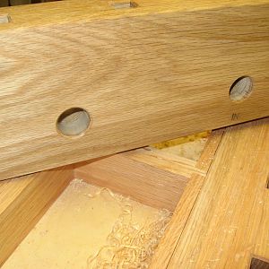

  16. Workbench build - face vice
    In the fully extended position

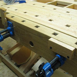

  17. Workbench build - face vice
    Fitted wooden blocks and screws serve as a latch to hold the face to the pipe clamp face.

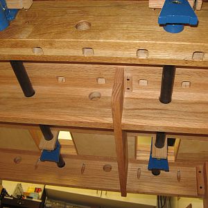

  18. Workbench build - face vice
    View of the pipe clamps from the bottom of the bench

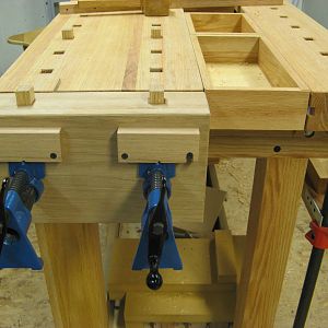

  19. Workbench build - face vice
    Two UHMW strips are inserted into each hole to conteract the tendency of the vice face block to tilt back on the pipe. You can see one strip at the bottom of the holes on the inside face. There is an additional strip on the top of the outside face. The pair tilts the face block forward slightly...

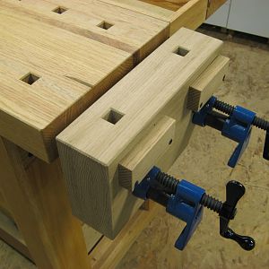

  20. Face vice built with pipe clamps
