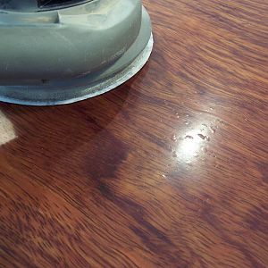

  9. BCT24 - Satin Finish Top
    The client wanted the varnish rubbed out to a Satin Finish -- three hours of careful sanding to remove the "nits" with 320 grit followed by 400, 600 and then 800 grit. Compare with BCT
  10. BCT23 - Contaminated Varnish
    Small varnish "nits" introduced during final coat from a contaminated brush

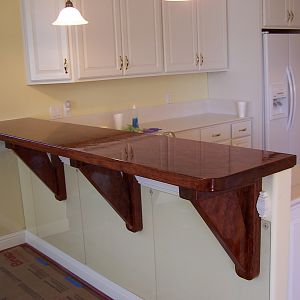

  11. BCT21 - View from the Kitchen
    The countertop sits right behind the kitchen sink and its stone backsplash. I sealed the 1/8" gap between the backsplash and the Bubinga with clear silicone caulk.

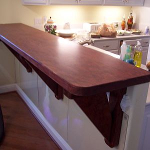

  12. BCT20 - View from Dining Room
    Here's a view from the Dining Room looking toward the countertop and the kitchen. The reflection off the drywall below the countertop is from Lexan I installed to protect the wall from being scuffed by careless feet sitting on stools...

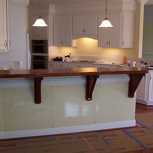

  13. BCT19 - Pet's Eye View
    A view from down low...

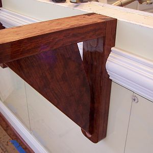

  14. BCT18 - Moment of Truth!
    My key issue was getting the 3 angle supports at the right height and coplanar with each other and the top of the stub wall (it was -- thanks to carefull use of a 4' level when installing the vertical members!). Less than 1/16" error which was taken up with a bed of clear silicone caulk on...

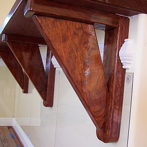

  15. BCT17 - Bracket Closeup
    The angle piece tenons were glued and the top support dovetail pin lowered into the tail cut into the vertical. When seated, the brackets were at a perfect 90º angle and the tops flush with the top stud in the stub wall. I drilled holes into the far side of the horizontal and vertical members...
  16. BCT16 - Brackets Installed
    After making careful saw cuts through the existing chair rail, the uprights were attached to the wall using a pair of 3/8" x 4" lag screws, hidden under the angle bracket when installed.

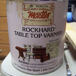

  17. BCT15 - Rockhard Table Top Varnish
    Here's the varnish -- Behlen's very durable short oil varnish -- impervious to about anything.
