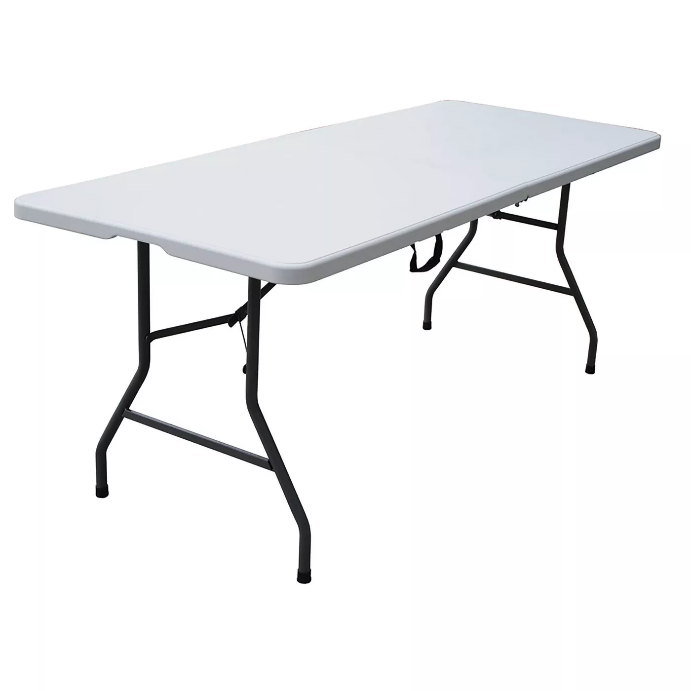

I got by with a sheet of 1" styrofoam insulation on the driveway/garage floor for a very long time. A "special" cutting table is very unnecessary.
The Styrofoam works well. One step up is to use one of these folding tables (which can be used for many other things) and put the Styrofoam on top. Easier on your back, and the table is big enough to support the wood and small enough to not interfere with any clamps you might want to use.
GUEST_dda37da5-4bc4-457e-9cde-f639581ef636
Cutting a sheet of plywood on the floor does eliminate the need to wrestle it on the table, that's always tricky, especially with such a light table that tends to slide around.
