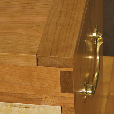

I’ve built a few bread board end tables from pine and cherry (8/4 and 6/4). I used three tenons on each table with a haunch similar to what is described and pictured in this article:
The tables have stood up to college students and younger children.

zdorsch
Zach
Matt,
The article I linked to explains the haunch. It’s more to help with alignment and to keep the perpendicular boards flat than strength. Some like to extend the haunch all the way to the end instead of leaving it short like in the picture. The tenons add strength. (I think this is what you’re asking?)
