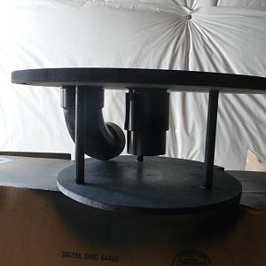

  1. P1070954
    P1070954
    shop vac head mounted to Thien separator

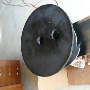

  2. P1070950
    P1070950

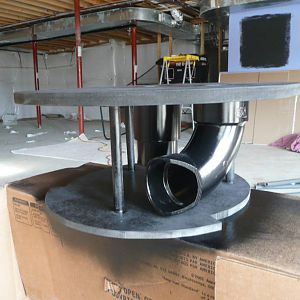

  3. P1070948
    P1070948

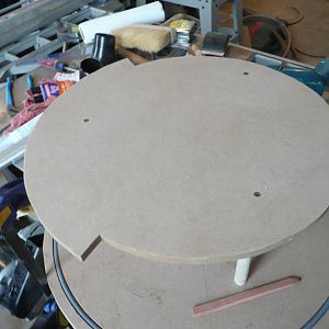

  4. P1070945
    P1070945

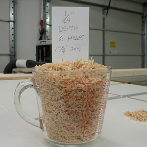

  12. 4th. Test
    4th. Test
    Elbow was moved to the 2nd position (middle). A 17-1/4'' 2x4 was passed through the planer 6 times, at 1/64'' depth. Performance appeared to be a little better about 5+ cups of sawdust was collected.

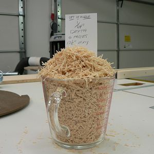

  13. 3rd. Test
    3rd. Test
    The elbow was moved to the 1st (original) position. A 17-1/4'' 2x4 was passed through the planer 6 times, at 1/64'' depth. Performance improved - about 5 cups of sawdust was collected.

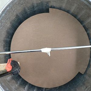

  14. Baffle Fit
    Baffle Fit
    Baffle located 8'' below top rim of trashcan. This can is slightly out-of-round, however the perfectly round lid appears to pull it back into shape.

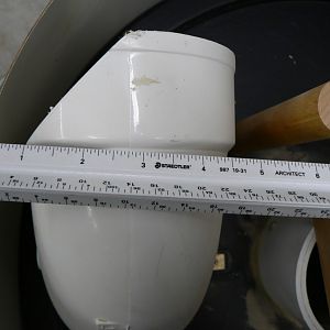

  15. Elbow Detail
    Elbow Detail
    Close up of elbow in optimum, 2nd position. The white laminate simulates side of trashcan.

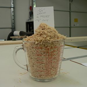

  16. 2nd Test
    2nd Test
    The elbow was positioned in the 3rd position, close to the side of the trashcan. A 17-1/4'' 2x4 was passed through the planer 6 times, at 1/64'' depth of cup. A little over 4 cups of sawdust was collected.

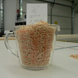

  17. 1st Test
    1st Test
    The elbow was positioned in the 3rd position, close to the side of the trashcan. A 17-1/4'' 2x4 was passed through the planer 3 times, at 1/32'' depth of cup. A little over 4 cups of sawdust was collected.

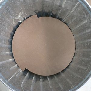

  18. Baffle Pattern
    Baffle Pattern
    The baffle was place in the bottom of the can to show to illustrate the sawdust pattern.

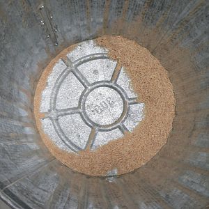

  19. Trashcan Sawdust
    Trashcan Sawdust
    The dust collector was run for 1 minute to see where the sawdust settled in the bottom of the can.
