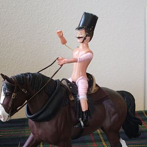

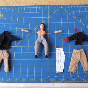

1:12 dolls-house/classical scale commercial plastic figure with limited motion, modified by cut-and-fill, adding a twisted-brass wire-armature for better pose-ability. After pulling out arms and legs, body was sealed with duck-tape except one leg hole for filling with Alumilite brand quick-setting thermo-plastic resin; after setting, holes were drilled and 4-twist of 26-ga wires were gorilla-glued into the holes. Skeleton will be covered with knitting-wool and cotton-wool. Hopefully, hands will be replaced!
