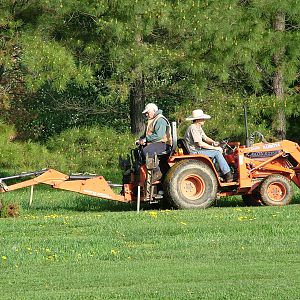

  1. The first step - cut the driveway
    Didn't have skid steer, so we slowly and painfully made our way with a pretty decent backhoe to cut about 300' of driveway. Thanks to Bob for the machine and the backhoe work.

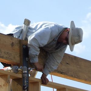

  4. Steel plates to secure beams to posts
    Cut the steel and made the holes with a plasma cutter. Then had to match drill all holes through (3) 2 x 12s and what was left of 6 x 6 after notching. Since what was left was so small, I used the steel plates.

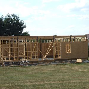

  5. Sheathing going up
    Sheathing going up

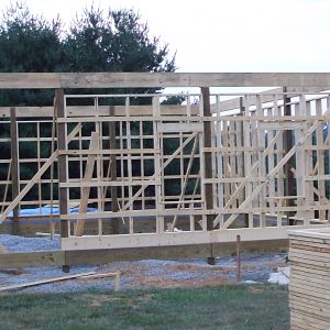

  6. Better view of studs and details
    Eight foot wide opening at left of pic is for front doors.

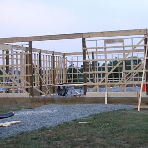

  8. Shear walls
    Shear walls
    Corner walls are built as shear walls to help stabilize the building and reduce movement.
  9. 2 x 6 studs
    2 x 6 studs
    Studs (at back of building) weren't permitted to touch the slab (as in conventional construction with a sill plate), so we held them off what would be the floor by 6". If they were to bear on the floor and the floor heaved from frost, they would jack up the building. The studs are to...

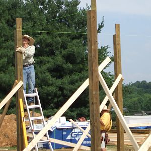

  11. String lines
    String lines

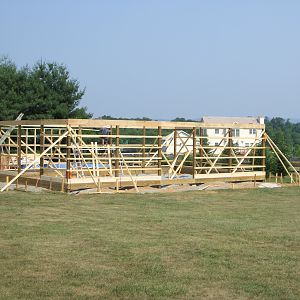

    Lots of measurement and verification for all aspects. There's a time to go fast and a time to go slow. This is the SLOW part. All poles are plumb, equidistant, with notches on the same plane.
  12. Lots of diagonal bracing
    6 x 6 poles with 2 x 12 band boards. My neighbor has a great view of the whole show.

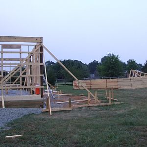

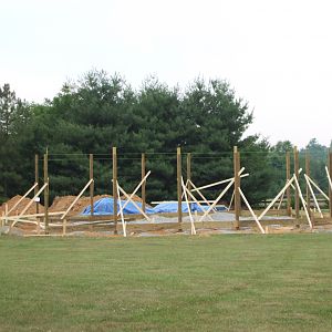

  13. Poles are all planted
    Now they just need water and fertilizer
