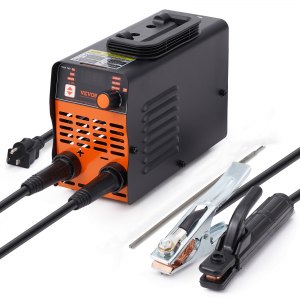

A few months ago I saw several ads for inverter welders; arc and TIG welding. Then the hoopla disappeared.
Has anyone tried one of the inverter welders (priced under $200)?

I've got one my dad bought from northern tool (I think that's where he got it).
It works well stick welding (more capable than I am) and it runs just fine off a 20A 120v outlet.
