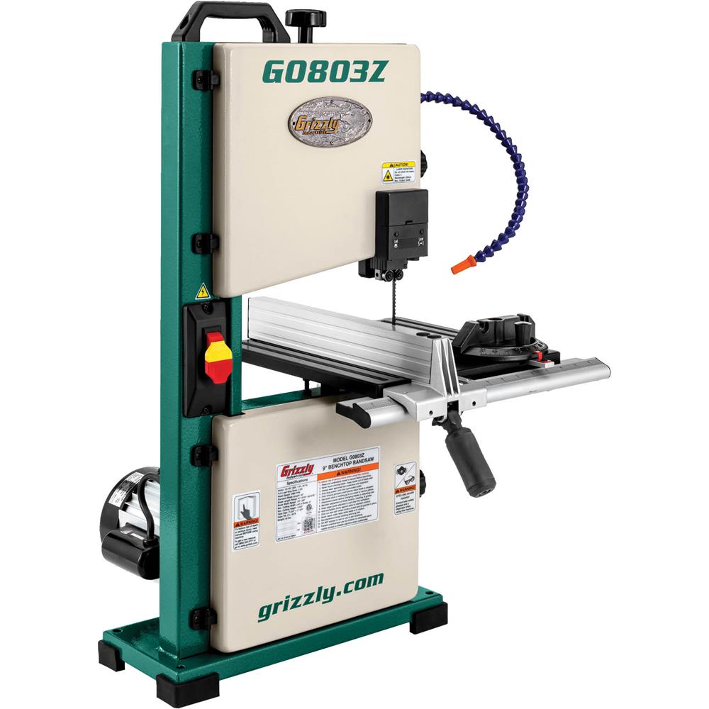

I am finding myself in need of a better bandsaw. I bought a Wen tabletop saw that I am supremely disappointed in. I am trying to use it to cut 1-3" thick blanks for turning, and it just doesn't seem to have the juice.
I'd like to get some input on a tabletop saw, keeping in mind I am not wanting to spend a pile of money, and it would be more for occasional use.
I did consider this one:
